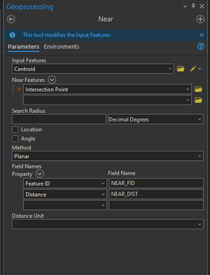

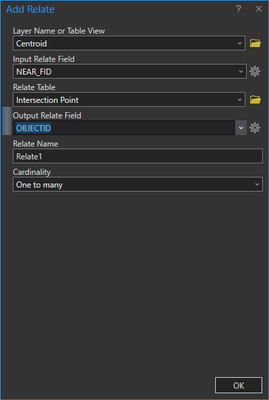

Hello Nicolas!
By your description, I think you used the Intersection points as your input to the Near tool. But you should use the Centroid as your Input Feature.
The Near Tool will create some fields in your Centroid feature, by default is Feature ID and Distance. The Feature ID field is the OBJECTID of your closest intersection point.
You can use this field to do a relationship between your tables with Add Relate Tool using the NEAR_FID in the Centroid and the OBJECTID of your Intersection Points.
After the relate, you can select your Intersection Points based on the Feature ID in the Centroid table. You can export the selected feature as your most central point having all the original attributes.
