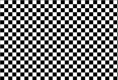

I created a mosaic dataset but when I zoom in appear the following issue:
Could you please let me know with should be the solution

normally it is due to broken paths
Repairing paths in a mosaic dataset—ArcGIS Pro | Documentation
but since you indicate that this is when you are zoomed in... try looking at this as a first step
Analyze Mosaic Dataset (Data Management)—ArcGIS Pro | Documentation
cell size issues were identified in the ArcMap help, but I can't find the equivalent link for Pro
Calculate Cell Size Ranges (Data Management)—ArcGIS Pro | Documentation

@Greta and after all the above, if they don't work, try rebuilding your overviews and replace all existing overviews (in the settings of the tool)
https://pro.arcgis.com/en/pro-app/latest/tool-reference/data-management/build-overviews.htm
