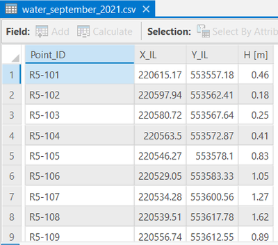

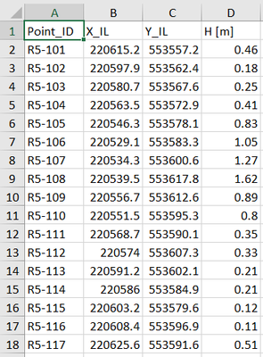

here is  how it show in the CSV file :
here is how it show in Arcgis :
these are the steps i did :
1. select all the rows in the CSV file
2. use XY point tool the select the column H [m] to be the Z feild
3. clicked Run
