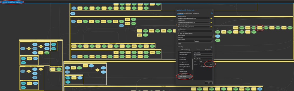

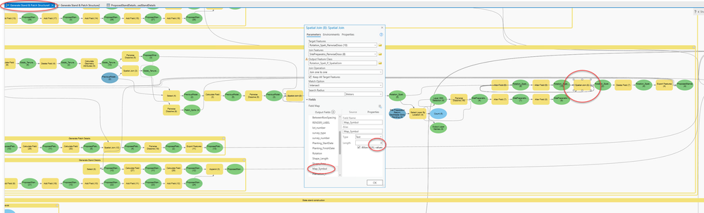

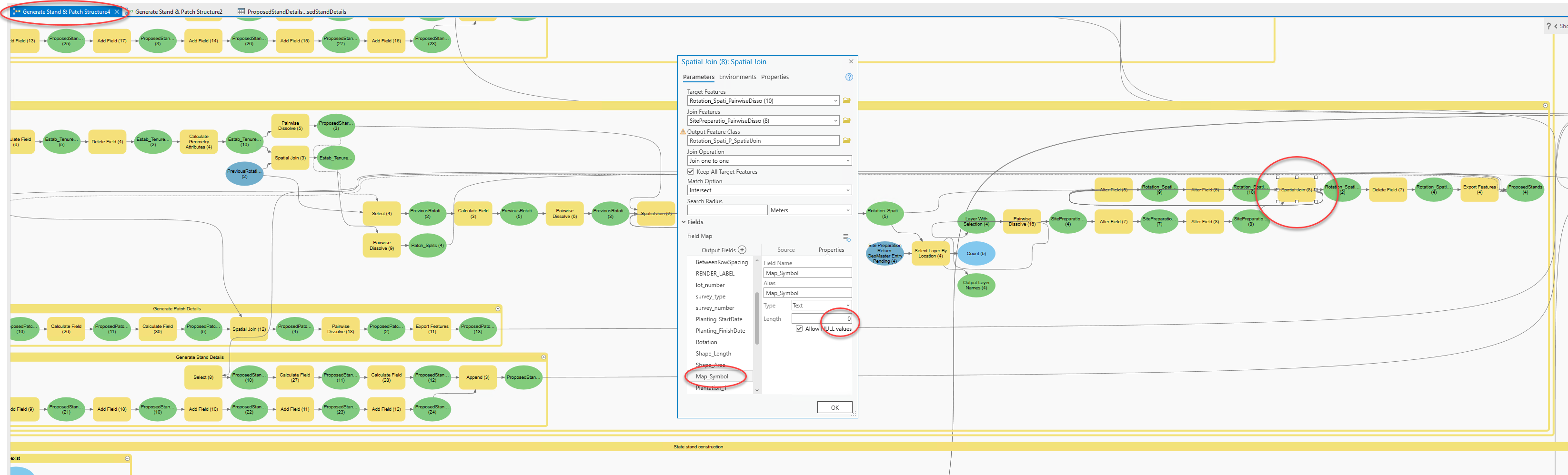

I've been investing a heap of time in building a new model to streamline a currently very manual data entry process - but have hit a HUGE road block. When I open the model on a different PC either as myself or as a different user, the field mappings in a number of Spatial Join and Export Feature tools constantly reset.
To be clear, I edit the model on my PC and see customised field maps (i.e. Text Field length = 512) but then open the exact same model in the same toolbox on a different machine and the field map has changed (i.e. Text Field = 0)! This is driving me nuts!
I've tried the following to get around/fix this, all to no avail!
- Do a Save As on the model within the toolbox
- Do a Save As into a new toolbox
- Create a new blank model and copy/paste the steps across
- Give up with my PC and work on it using a remote server login. Even this isn't working as I got a colleague to open it and she isn't seeing the latest field mapping
Please please please can someone suggest something I can try to stop this happening! I've had this happen before, and have just given up and walked away and either it started working again or I started again from scratch (not something I want to have to do now). I suspect it's my user profile, but can't be sure.
The below screenshots are of the same model but opened on my PC and opened on the remote server.

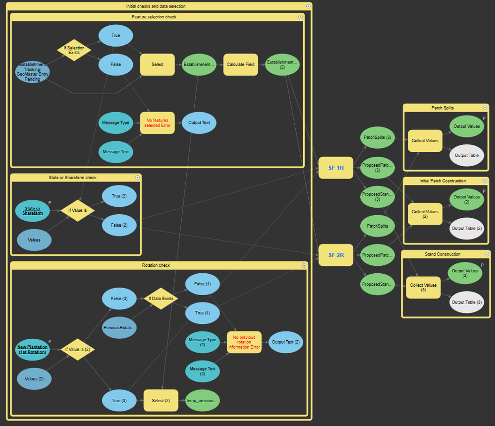

I think I've figured out where the problem was/is. The issue reared it's head again in my new model despite starting from scratch in a new model and toolbox. It occured after I finished building one of the large blocks of tools, which I would then copy and paste to use as the basis of the 2nd large block but with customisations to suit the different parameters.
Instead, I put these large blocks into submodels (blue text in image below) and when I opened the model and submodels on my other machine and checked the field mapping, they were retained!
Solution in short: Use submodels where possible for large blocks of tools (especially when copy/pasting those blocks).
