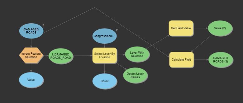

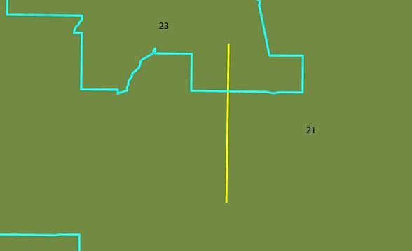

I have a polyline that intersects two polygons and I want to calculate the field of the line with the two polygon values(District 23 & District 21) that are selected. Before reaching out for help, I wanted to research this issue myself.
I am currently using Model Builder because I need to do this function for a lot more roads in my polyline feature class.
The model below works when I want to calculate the field with a single value that selected but not when there are multiple..
Thank you
-Mike
Model Builder - Calculate Field w Values_.JPGModel Builder - Calculate Field w Values_.JPGModel Builder - Calculate Field_Select By Location.JPGModel Builder - Calculate Field_Select By Location.JPG
RhettZufelt
MVP Notable Contributor
Using the join merge option in spatial join will do that.  This post describes it pretty well.  It is for ArcMap, but Pro has the same options, and spatial join can be included in a model as well.
R_
RhettZufelt
R_
MikeRodriguez
Thank you! It worked out perfectly.
