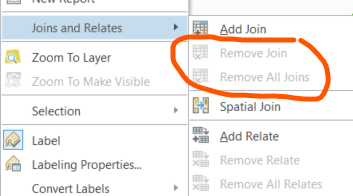

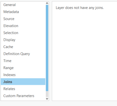

I'm trying to join two feature services with a common field through model builder.  It works properly when I run the standard Add Join tool through the geoprocessing pane.  I then go to the geoprocessing history, use the successful result Add to Model and save the new model.  When I run the new model from my toolbox, it will not work properly.  It says it completes successfully, but there is no join afterwards.  What is going wrong?  Attached below is the python script from model builder (I am not familiar with python).  I'm using Pro 2.8.1

LukeGilner1
Well....maybe it is working.  I continued the model with some Calculate Fields to pull attributes from the joined feature, and the attributes pulled through correctly.  Why doesn't it show that there is a join on the feature when I run my tool from the toolbox, but it does when I run it directly from model builder?

LukeGilner1
Yes, these two feature services in the join are in my current map contents when I run the tool from the toolbox.
