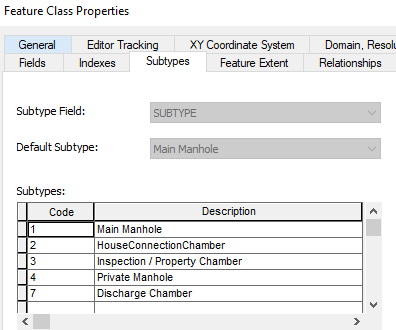

Kindly, Using ArcGIS Pro 2.8 I'm trying to export the feature class from SDE to FGDB using the tool (Feature Class to Geodatabase). Unfortunately, the output comes without the subtypes which are mainly in the description of the Subtype. it just the numbers of codes
I tried with ArcMap10.8 using the same tool and it worked well.
and this how the data looks like in subtype.
Any thoughts to solve the issue in the Pro?
