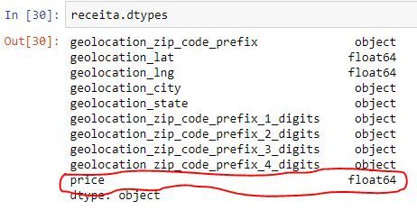

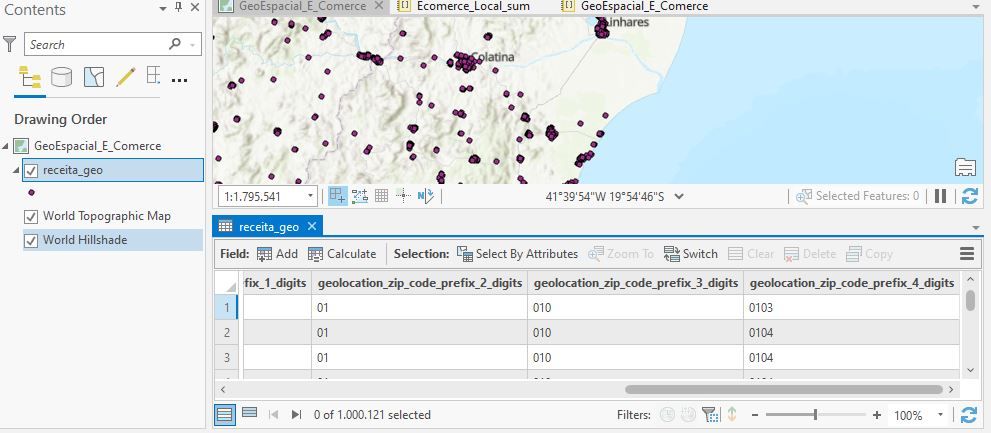

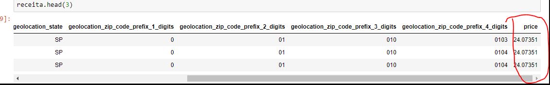

The procedure is executed without error, however when looking in the attributes table the "price" field (flot64) is ignored and does not appear in the attributes table.
Any tips about it?
