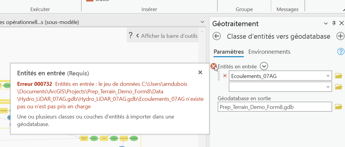

Hello everyone,
I'm experiencing a troubling issue. I'm currently working with ArcGIS Pro 3.2.1 (patch installed). I have a gdb with 1 linear feature class and 2 polygonal features classes. I can add all data to a project and visualize it and make selections. I can also safely use tools to perform different transformations, as long as I point the loaded data in the map in entry.
However, when I try to perform anything from the catalog or load the data in a model builder, ArcGIS displays error messages saying that data is either missing or not supported (see below for French version of the error message).

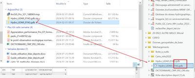

your path is strange
...\Hydro_LIDAR_07AG.gdb\Hydro_LIDAR_07AG.gdb...
I suspect that you don't actually have that gdb within itself.
... sort of retired...
Anne-MarieDubois
@DanPatterson
I was coming along to answer to my own post. I think you sent some waves my way cause this is exactly what I've just figured out!! It turns out when I unzipped my gdb, the folder it is stored in takes the same name as the gdb PLUS the extension (which is totally stupid)
I just corrected the folder name and it works all fine. Fiouuu
