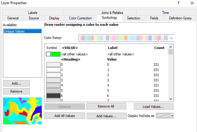

I have an ArcMap layer that is sourcing from a Raster Catalogue. It has Symbology settings setup on it as seen in the screenshot that displays the raster imagery in greyscale.
I want to replicate these exact Symbology settings now in ArcGIS Pro in an .lyrx file, which now sources the exact same raster imagery from a Mosaic Dataset. What's the best way I can import these ArcMap Symbology settings into my new ArcGIS Pro layer?
I tried to importing the .lyr file into Pro but I get "Layer type is not supported".

Unfortunately this doesn't work either. I select Import from layer file, choose the .lyr file, and it says "Failed to display the raster layer as Stretched".
