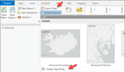

you can use either Import Map or Import Layout option from the Insert ribbon to import an ArcMap template (.mxd) in Pro and then save that out as a Layout File (.pagx) to be used in a print service published from ArcGIS Pro.
Importing an mxd...
