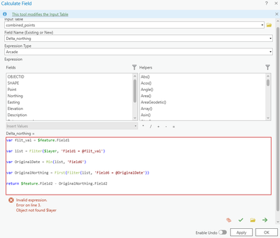

Second, I tried your code and get an object error:
Earlier I tried using $layer and was getting an object error so I changed it to $featureset as shown in my code above. If I do this in your code it ends up causing another error in in line 7. Any thoughts on what could be causing the object error?

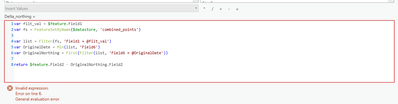

One step closer, now I am getting a general evaluation error for line 6. Is this a syntax issue?
var filt_val = $feature.Field1
var fs = FeatureSetByName($datastore, 'combined_points')
var list = Filter(fs, 'Field1 = @filt_val')
var OriginalDate = Min(list, 'Field6')
var OriginalNorthing = First(Filter(list, 'Field6 = @OriginalDate'))
return $feature.Field2 - OriginalNorthing.Field2
jcarlson
MVP Alum
Strange. I think it would tell us if it was syntax related. Any chance this layer is accessible in a web map?

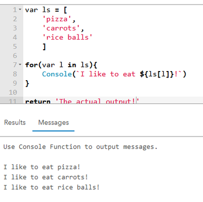

If you can utilize the AGOL / Portal expression builder, you can use the Console command to output intermediate things, like the contents of your list and OriginalDate objects, to make sure that the preceding steps are going as intended.
Barring that, you'll just have to figure out some other way of testing the individual components of this expression. Try putting the First function on its own line, perhaps, to see if that's the cause.
Or maybe it's related to how you're assembling the query? According to the docs, there are database-specific ways to indicate that you're supplying a datetime value.
