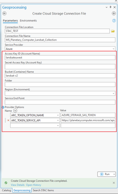

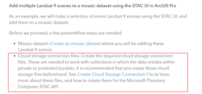

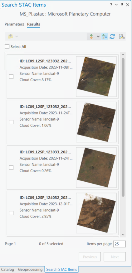

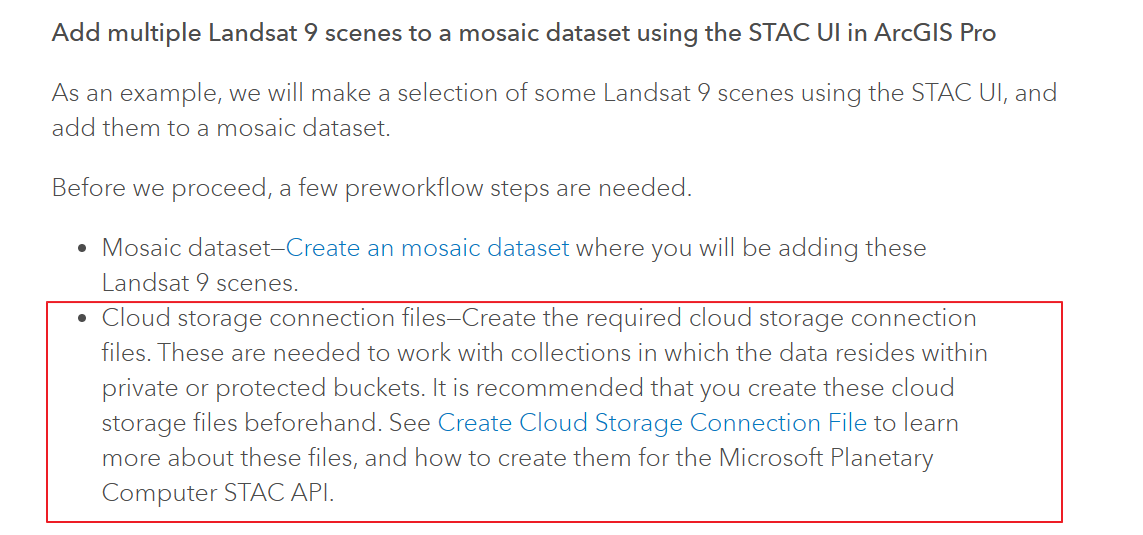

I followed your instructions on the blog regarding STAC (Introduction to the STAC UI in ArcGIS Pro (esri.com)). However I get very confused in this part (please see pic below)where we are supposed to create a cloud storage connecton file. Can you elaborate on the this part? Does it mean I need to create my own Azure account first?

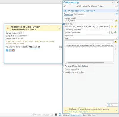

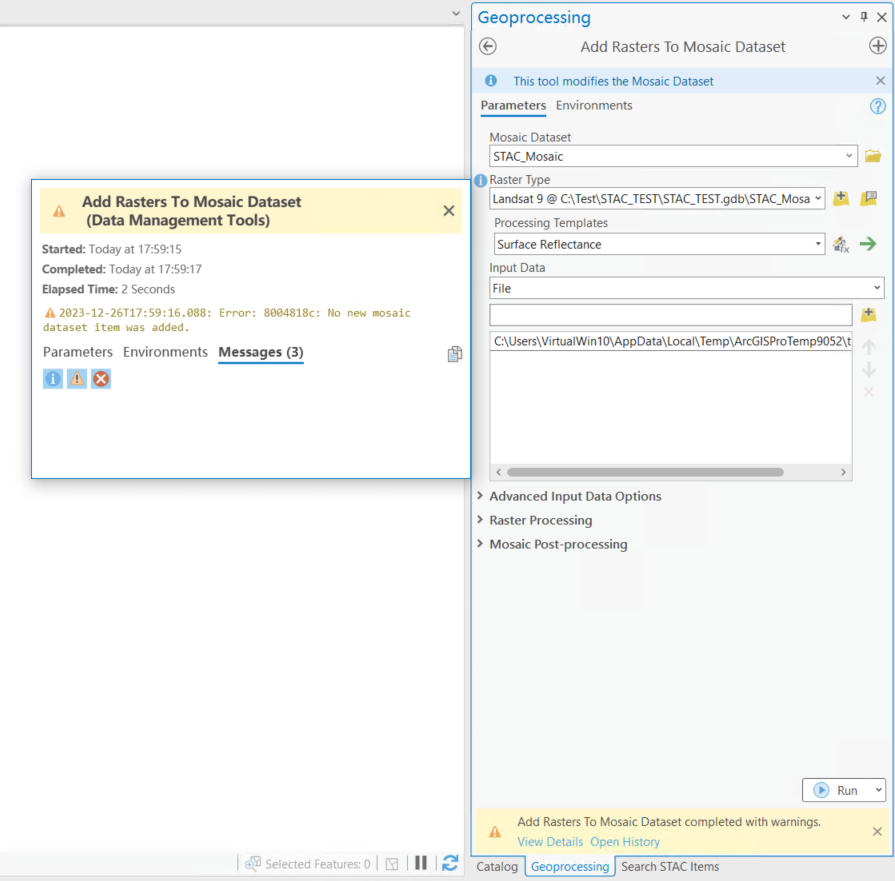

In the end, I skipped this step and found out I can still get the search result but unable to add the image to the mosaic dataset, is this caused by the lack of cloud storage connection file?

The STAC API endpoint is public so you're able to discover the assets. When you go to use the asset(s) though you will need an ACS connection. You don't need an Azure account to create ACS files.
This documentation describes how to create the cloud storage connection files  https://pro.arcgis.com/en/pro-app/latest/tool-reference/data-management/create-cloud-storage-connect... Be sure and change to the Python tab and the last python example you'll see is for creating the connection to Microsoft Planetary Computer (MPC) Landsat collection. The unique aspect here in CreateCloudStorageConnectionFile function is around the concept of connecting with "token vending service". For each collection in the MPC there is a different set of parameters that you'll name to make the connection. Specifically, accesskey, bucketname, and ARC_TOKEN_SERVICE_API will vary.
As an alternative to creating them yourself, you can also download them from the ArcGIS for the Microsoft Planetary Computer (AMPC) repository at https://github.com/Esri/arcgis-for-mpc
PLEASE NOTE: If you are intending to conduct any analysis at scale, do deploy a virtual machine with ArcGIS Pro in the Azure West Europe region right next to the data. You can do this manually or through the Azure  Marketplace AMPC listing https://azuremarketplace.microsoft.com/en/marketplace/apps/esri.arcgis-4mpc-template?tab=Overview and take advantage of the options that you need for your particular workflow. More info on the AMPC here: https://doc.arcgis.com/en/microsoft-planetary-computer/latest/help/get-started-with-arcgis-for-micro...

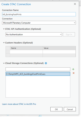

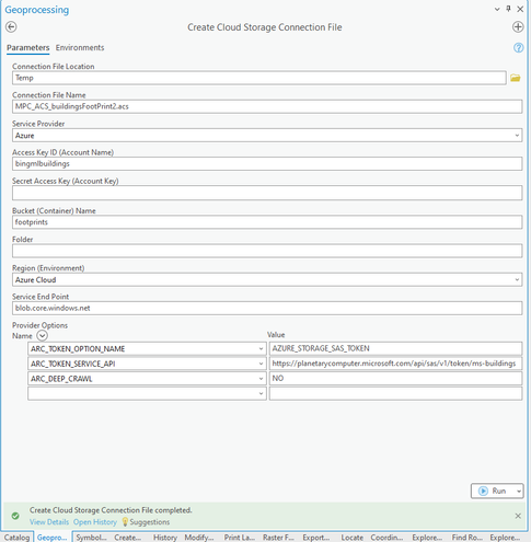

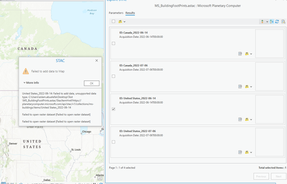

I have a similar issue here, as I am trying to get Microsoft Building Footprints  into my ArcGIS Pro. I followed the steps you described preciously, though I got an error states "Failed to add" whenever trying to add any building footprint to the map.
The ACS file parameters I used are shown below:
The STAC connection details are as below:
The error is as follows:
DavidWright
Hi Eslam,
Looks like you took all the necessary steps but at this time the STAC Connections in ArcGIS Pro are supporting only raster datasets. My hope is that support for other data types will be introduced. For now, there are some alternatives to loading the Microsoft Building Footprints content in ArcGIS. Please have a look at these resources and see if they meet your needs.
https://hub.arcgis.com/datasets/esri::microsoft-building-footprints-features/about
or:
https://gavinr.com/getting-the-microsoft-us-building-footprints-into-arcgis-pro/
