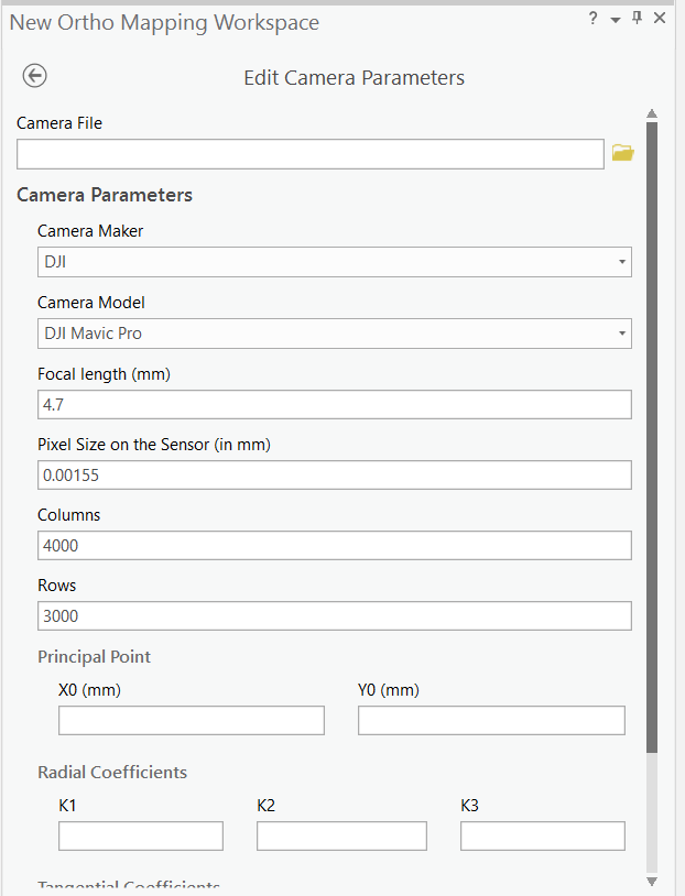

Hello, I am using ArcGIS Pro 2.3.0 to construct an orthomosaic from a mapping mission I flew. The problem is that the Mavic 2 Pro is not one of the "Camera Models" that Esri has made yet. This wouldn't be a problem as you can edit the camera parameters but when I compare the Mavic Pro's automated setting to the online settings I can not draw clear coloration to what Esri has vs what I find as the specs for the Mavic Pro. For instance the Focal Length in (mm) that is auto filed in by ArcGIS Pro is 4.7 when the focal length of the Mavic Pro is actually 28 mm.
This leads me to not trust what I would enter in to the fields and am looking for someone more experienced in this to help me make this workflow accurate. I can not find anyone else posting about this so I hope this helps someone else and we can work on it together after we try a few settings.

I've been able to successfully process some orthomosaics from aerial images captured with the DJI Mavic 2 Pro in ArcGIS Pro.  Below are the settings I used...

Yeah I agree the L1D-20c isn't a preloaded camera option...that would be nice. I manually entered the camera parameters based on some info that I pieced together from other online sources.  Not sure if it is exactly right but my orthomasics come out fine.  No such luck on generating a DSM or DEM as I always get the below error message.

I am having the same problem with the DJI Mavic Pro 2. I used your settings above with Focal Length equal to 10.3 and Pixel size equal to 0.0024 but it still did not work when I run block adjustment. I get the following error:

I'm on 2.4.1 and the Camera db does not have this L1D-20c yet. The model has been their for awhile and will ESRI is updating the db. People buy new drones all the time .
The focal length = 10.3 and pixel size 0.00155 did not work for me.

I am going to post this here for future reference. I did the calculation per ESRI's instruction posted here, and block adjustment worked for me. Let me know if you come up with different results...
Equations for Pixel Size:
Pixel Size = CCD Diagonal / Image Diagonal(in pixels)
WHERE
CCD Diagonal = 2 * (Focal Length * Tan(FOV/2))
Mavic Pro 2 Camera Spec
Camera: Hasselblad l1d-20c
If,
Focal Length = 10.3 mm
Field of View (FOV) = 77°
Image Diagonal = 3678 (in pixels)
CCD Diagonal = 2 * (10.3 * Tan(77/2)) = 16.386
Therefore,
Pixel Size = 16.386 / 3678 = .00446
**PS: I agree ESRI should update the database for the Hasselblad l1d-20c camera specs since it is a popular drone and great camera, but I hope this is helpful for now.
