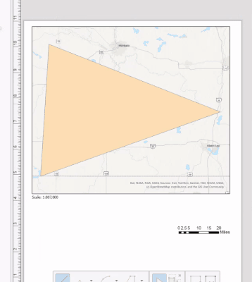

This doesn't 100% solve the problem, but along those lines, you can apply a visibility scale to each scalebar so they automatically turn off and on with each map in the series.  
For example, the scalebar on the left is visible further away than 1:1,000,000, but the one on the right is for the more zoomed-in pages.
I agree that a new fitting strategy of "Maintain maximum and minimum size but make each division be a round number like 5 or 10 or 0.5" would be great, and if you wrote an Idea for it I would happily upvote it.
NavaSheer
Thank you! Great workaround!  I never realised there was a visibilty scale  for the scale.  And now I see it was right in front of me.   But I will also write an idea to improve the scale bar to work better in map series.🙏
