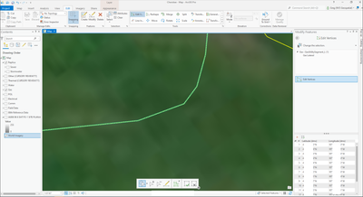

Selection color is set to the default color. A line is selected. The vertex x/y locations are showing in the Modify Features window for the selected feature.

The user can still "select" vertices and move them. Problem is with displaying them.

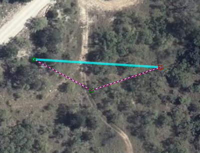

A vertex in the table of coordinates can be selected but does not display. It can be zoomed to, deleted etc. We are also still able to add vertices along the line. You can still click on and move a vertex at a "change in direction on the line" but the vertices will not display like in the image below.
Intent is to move vertex on the line to a different location but some of the changes in direction are so small that a vertex needs to be seen in order to move it.

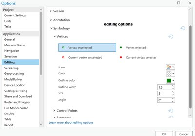

CarsonG
Line style is a simple 1.5 width yellow line. No additional markers have been added to the line. I've looked in the editing options for some setting that may disable them.
