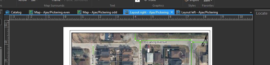

Thanks for responding.  That is basically what I decided to do within my ArcPro project but without all the code.  I just created two maps/layouts, one for the right side and one for the left side.
The ArcMap MapLogic product works without having to make multiple layouts though.  Instead, you create what they call an 'anchor' point, and your layout elements move around the anchor point depending on whether you are looking at an even or odd # page.  I was hoping ArcPro would incorporate a feature like that, but I guess not.
