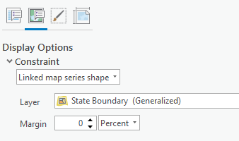

Are you talking about a reference map that shows the full extent of your system and where the current map page is centered on?
Like the inset above?
To do this Insert a New Map Frame into your Layout.  Add to it the features you want in the inset. Now this map series spans Minnesota, Wisconsin, North Dakota and South Dakota So to the Inset I add the state boundary as well.
Then in the Display Options (second properties tab)
The constraint is the Map Series Polygons that will be circled in red and the State Boundary that the map series polygon fits in will be centered in the window.
I the image below I selected a North Dakota grid and it swapped the Inset to North Dakota

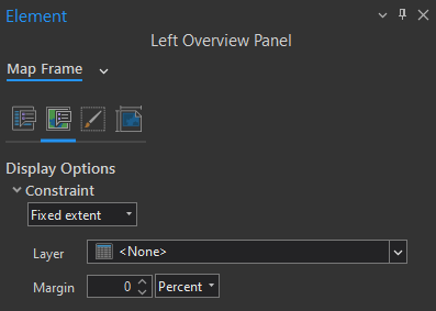

HannahAWhite
Thanks, Robert! No python needed, folks. Not sure why this isn't flagged as the answer. Major kudos! Learn somethin' new every day 🙂
Just go into the Layout properties of your inset map (or in my case, a side panel map) and set the Display Constraint to "Fixed extent." I didn't have to specify a layer. I merely adjusted the map extent to where I wanted it beforehand, and then set the constraint afterwards.

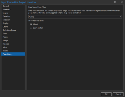

Now, when the map series changes, the map doesn't move, but different features appear based on an attribute (forgot to mention, I also have a Page Query defined for the specific layer in the map that I want to display dynamically, based on the map series -- see below).
Set a Page Query on your layer and indicate what attribute needs to match the map series in order to be displayed.
Hope this helps someone!

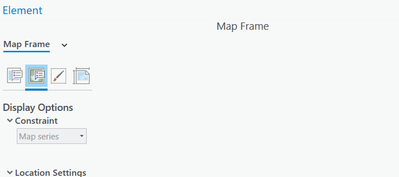

RomuDeininger
Unfortunately, the Display Constraint "Fixed extent." is not shown, only "Map series"...
