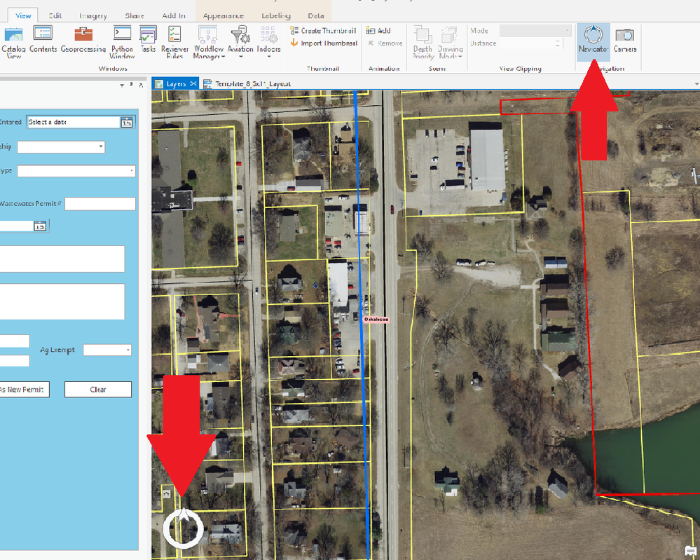

How do I turn on my map scroll bars in Pro?

I don't think there is one available.  A better option for you is to use the Navigator.  It's under the view tab -> Navigation group.

Mariyana: Have you tried using the "Heading" compass? I just discovered it. Under Options--> Navigations-->On Screen Navigator-->Pull down to either Heading or Full Control. Both create a compass rose thing in your map window. You can press on different sides and it will scroll. (It also will change your north heading if you're not careful.) But you can press on the ring and it will scroll in that direction. Maybe that is the thing that is supposed to replace the scroll bars.
