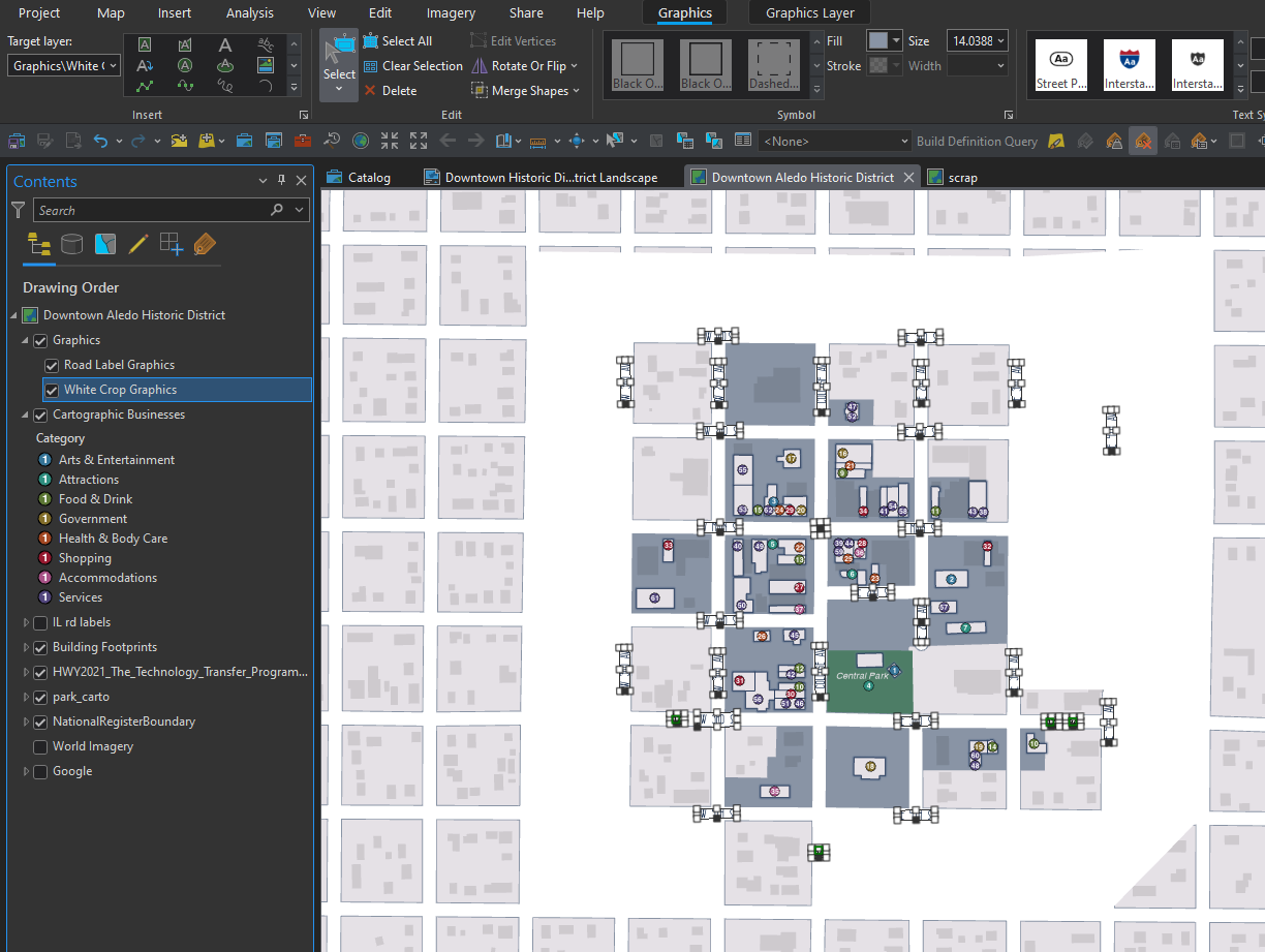

Hi all, I am curious what the workaround is to a map graphics layer becoming unselectable. I have two graphics layers in my map, one for labels and one containing a white polygon for some layout trickery. However, I'm no longer able to select that polygon or edit its vertices.

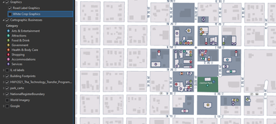

I can't click it with the graphic select tool (even when Target Layer is set to that one), and Select All only picks up my road labels:

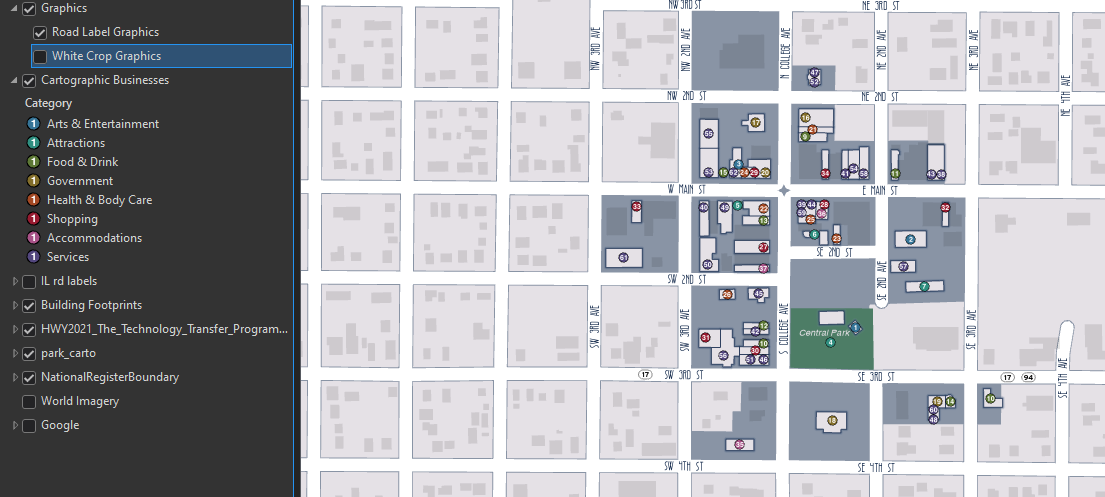

Graphics also have no TOC/layers pane for selection that way as far as I know, but I know it's in that layer because it turns off when I uncheck its box:
