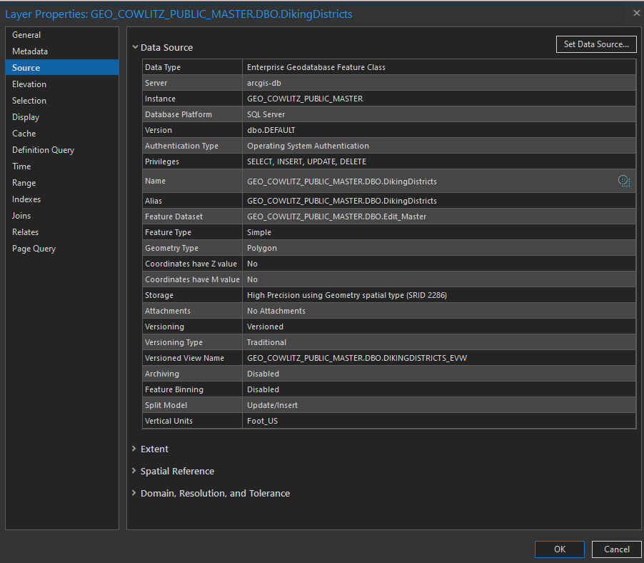

This is an example of the editable feature class:

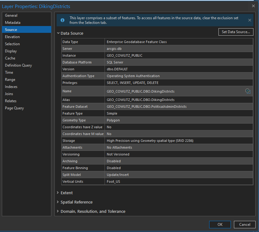

This is the copy:
This is the layer file that should not  be editable:

In reviewing the non-editable layer file information, this feature class is has full editing enable (select, insert, update, delete privileges).  What I would do is create a database view of the layer in question.  By default, it's read-only.  Users can visualize, change the symbology, label and more but cannot edit the data.  As a database view, you can set its privileges to a database role and/or database user.
