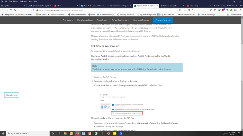

It seems that you cannot connect to the ArcGIS World Geocoding Service
Problem: ArcGIS World Geocoding Service does not display in ArcGIS Pro (esri.com)

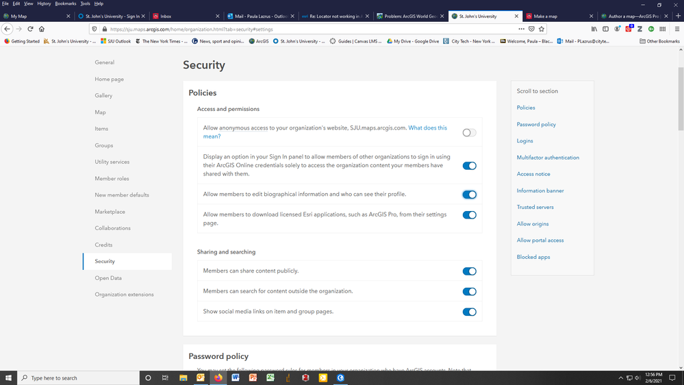

Ok, this seems to be part of the problem but when I follow the directions I'm missing the option to turn on the box I need to activate.  See attached, the instructions, and what I see.  Sigh.Screenshot (209).pngScreenshot (209).pngScreenshot (210).pngScreenshot (210).png
PaulaLazrus
Hello , Thanks for the help so far, I followed the directions in the link to solve the problem but the option I need to activate doesn't seem to be there. See the attached files. One is the instructions and the other what I see.
As always grateful to this community for help.

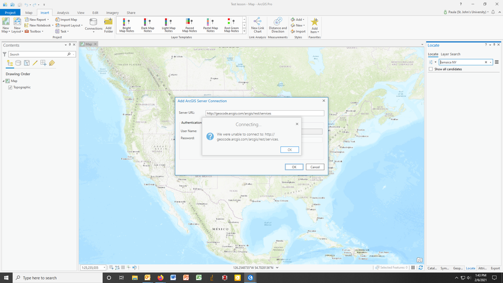

So I tried this (had done it before actually but that didn't solve my problem either!)  If I try to connect to the server with the provided address I get the following error Screenshot (213).pngScreenshot (213).png
PaulaLazrus
Craziness, but I wanted to say Thank you and I fixed it.  The fix was the usual sort of infuriatingly simple computer issue.  So I decided to give the connections to a new arcgis online server a go one more time. I put in the same address as above, and then before accepting I added an S after the http.   It worked, and I was able then to go to settings in locator and sort it all out.  Don't know if it sticks, but I have a solution.
