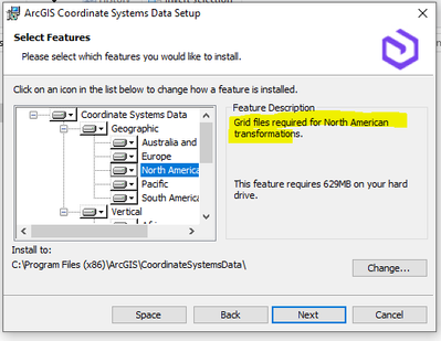

Have you tried loading the CoordinateSystemsData for ArcGIS Pro? This install MSI is available from my.esri.com, downloads. These are needed if you did a per user install vs. per machine.

Have you tried loading the CoordinateSystemsData for ArcGIS Pro? These are needed if you did a per user install vs. per machine.
