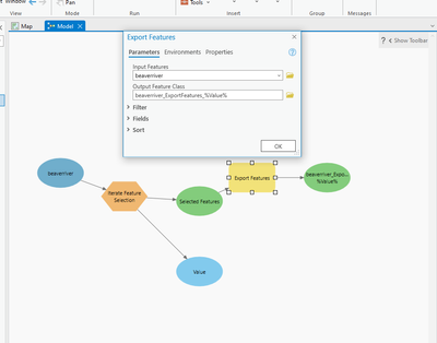

There is definitely a way to loop over features using Model Builder. In this case, you can use the Feature Selection Iterator:
https://pro.arcgis.com/en/pro-app/2.9/tool-reference/modelbuilder-toolbox/iterate-feature-selection....

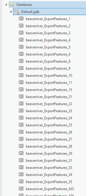

By default, this selects each record in the attribute table and you can use the ObjectID value to output a specific feature class name:
In the example above, I connected my beaverriver feature class to the Iterate Feature Selection tool. From each selected feature, I am exporting it to a new feature class with a new name "beaverriver_ExportFeatures_%Value%". The %Value% tag takes the ObjectID value from the iterator and inserts it into the output feature class name. The result is as follows:
Hopefully this will give you an error at a specific record(s).
