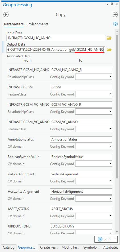

The Copy tool is equivalent to copy/pasting on the catalog pane. But something I noticed in your screenshot is that you did not provide a name for your output data. Could you try providing a name for the annotation fc?
In our quick testing, I could get the same error if the output was going to a gdb without specifying a name.
Bud
@MargaretCrawford
Yes, specifying a FC name worked. Thanks.

I also want to clariify how ERROR 000979 comes to be:
In Bud's screenshot we see only the data names, for both Input and Output, not the full data path. [Yes, data can have a period in their name].
In this screenshot we see the full data path
The Output Data path results from  pasting a Copy Path. The paste replaced Copy's default generated output path.
According to this screenshot the input 'clip' FC would be copied from a fGDB as "test.gdb" to the folder 'inputjson', two different workspace types, thus causing ERROR 000979.
