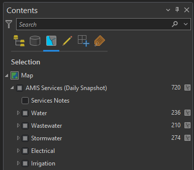

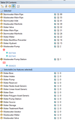

I know this is an old thread, but I've just struck this for the first time in Pro.
Use case is selecting multiple features to input into the Export to CAD tool.
The user selects the features on the map (which are stored in multiple groups).
In ArcMap, the user can change to List By Selection and all the selected layers are automatically moved to the top of the list. The user can easily shift select all of them and drag them into the Export to CAD tool in one go.
MarlboroughDistrict_Council_0-1741746771057.pngMarlboroughDistrict_Council_0-1741746771057.png

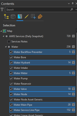

In Pro, there does not appear to be a way to view selected features like this. Instead the user has to open multiple groups, do Ctrl-Click within each group and drag those layers into the Export to CAD tool. Its much more time intensive and easy to miss a layer.
MarlboroughDistrict_Council_2-1741746864005.pngMarlboroughDistrict_Council_2-1741746864005.pngMarlboroughDistrict_Council_3-1741746878897.pngMarlboroughDistrict_Council_3-1741746878897.png
Is there any plan to provide an option to sort the Selection panel in Pro so selected layers go to the top?
