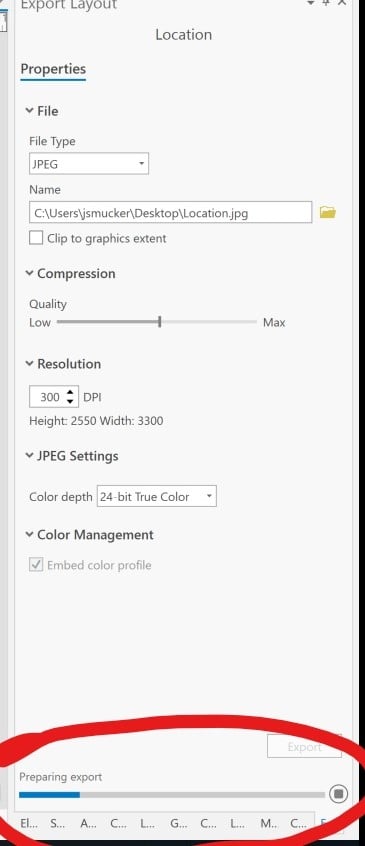

Hello. Almost every time I export a layout in ArcGIS Pro 2.5, it takes 20 minutes. I tried turning on and off different layers, locking elements, exporting to my local drive, changing DPI, changing the file type, etc. I am not loading a lot of data. The "preparing to export" portion takes about 18 minutes and then the "export in progress" takes about 2 minutes. Is there a certain setting that I am missing? This did not happen with earlier versions of Pro. #arcgispro2.5 #export #slow #performance

UPDATE: I used the python window to export with this simple code...and it only took a few seconds!
aprx = arcpy.mp.ArcGISProject("CURRENT")
for lyt in aprx.listLayouts("Location"):
      lyt.exportToPNG("C:\\Users\\jsmucker\\Desktop\\Test2", 200)
Anyone know why the the python window would work this quickly, but not the tool?

Works for me, but another odd issue here, is you have a DPI setting and I do not.....

That's weird! I wonder why...
