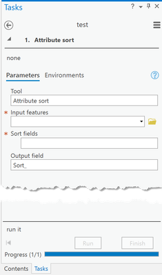

I "record"ed the steps or running one of my toolset tools and it seems to have incorporated it.  I haven't played with Tasks, so this may or may not work.
