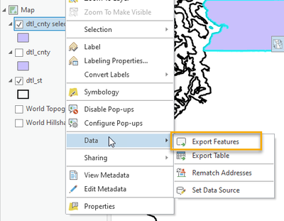

I like to select the boundary in the layer, the right-click on the layer in the Contents Pane and choose Data -> Export Features. This will create a new feature class with only the selected polygon.

  • If you need separate feature classes / shape files for each boundary (different data structure), go with Aubri's solution: Export the features from the original layer into three different feature classes, then delete the unneeded features in each feature class.
  • If you only need to show the boundaries indepently from each other (different representation), copy the layer three times and set the defniition query of each layer: Filter features with definition queries—ArcGIS Pro | Documentation
