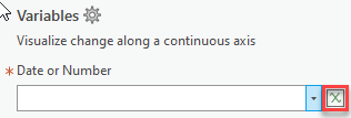

1) Temporal line charts that aggregate by count should automatically fill in missing data points with zero. Based on your description, I'm assuming your x-axis field is an integer rather than a date. In this case, I'd suggest using an Arcade expression to convert your integer "year" field into a date. You would do this by clicking the "Set an expression" button to the right of the Date or Number dropdown:

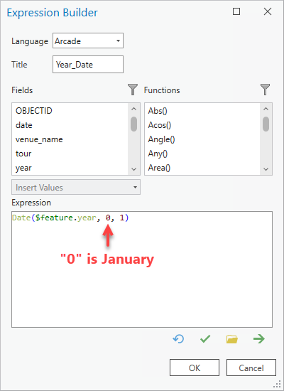

And then you would use the Date function to construct a date field, passing the "year" field as the year and using January 1st as the month and day:
