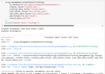

I am getting errors when I try to enable editor tracking on a table (feature class works fine) in a file geodatabase, both in the management properties menu and a Jupyter notebook.

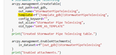

Snippet showing the use of a template table which already has the editor tracking fields.
Enable Editor Tracking method failing (this screenshot shows a different table, but same problem):

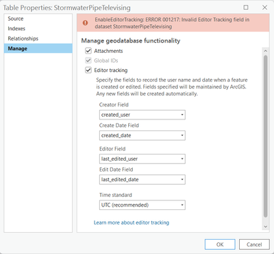

Try to enable manually, but get ERROR 001217:

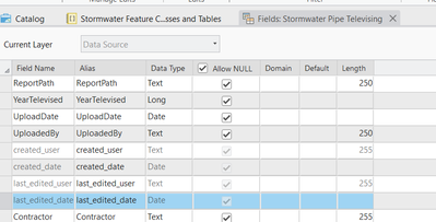

Fields with correct data types that exist upon table creation, via the applied template:
(Note that I can not delete these fields even though editor tracking is not enabled yet)
I am able to do this with feature classes, which leads me to believe this may be buggy behavior?

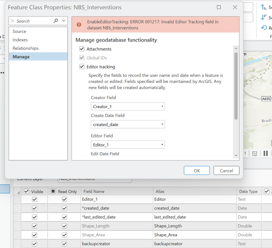

I'm not using Python but have a similar issue which I believe is related to this bug: https://support.esri.com/en-us/bug/when-a-layer-from-arcgis-online-is-exported-to-a-geodat-bug-00016...

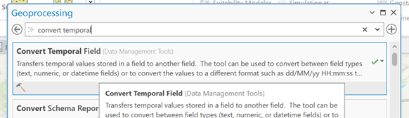

When trying to republish a layer and activate editor tracking again, the date fields cannot be used under editor tracking due to error 001217, but they also cannot be deleted or thier properties edited either - it would be quite easy to republish the layer without realising that the date fields are not recording any changes. I resolved this in ArcGIS Pro by using the 'conconvert temporal fields.pngeditor fields error.pngvert temporal field' tool. I converted first to text, and then converted again to date. Then I deleted the old fields (which could not be deleted under 'fields') by exporting to a new feature class, and then renaming them during the export.
