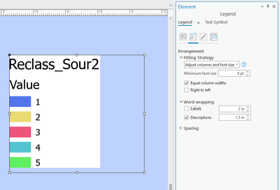

When I create a legend it creates extra white space on the right side. The gap adjustments or changing the fitting strategy don't seem to fix this. Any thoughts? (see pic)

Thanks for reaching out! It definitely looks like there might be a bug in the software that's not allowing you to remove that extra white space from the legend. I was able to reproduce what you were seeing using a raster layer with the Unique Values renderer.

In the meantime, if your legend is going to be static, a workaround would be to make the background of your legend transparent, insert a new Rectangle shape from the Graphics and Text gallery, resize it to the desired width, and place the legend on top. You can then group the two elements together (Legend and Rectangle) to keep them as one object going forward.

When I was able to reproduce in December, I had word wrapping enabled for the labels in the Legend and I'm wondering if that's where you're running into an issue.
This is a Legend with a white background where the word wrapping is enabled for the labels and descriptions. When word wrapping is enabled, the white space is maintained even when you try and resize the legend.
When you disable the word wrapping for the labels, the white background resizes to the size of the longest piece of text in the legend.

That was it, Julia!  Thank you.  The checkboxes in ArcGIS Pro are like a missing semi colon in code - tiny but powerful.
