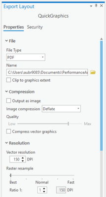

AubriOtis
That's not good at all. Line and rectangle graphics from an imported MXD are showing up in my PDF export, could you possibly share your export settings? This is what I was using:
Cheers,
Aubri
by Anonymous User
Not applicable
The difference in my export settings were ...
Image Compression: Adaptive
DPI: 300
by Anonymous User
Not applicable
i have since uninstalled 2.7 and am working on 2.6 because of my workload
