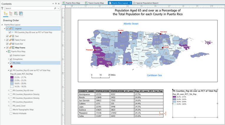

...more trouble with the Layout Legend/Items as an element in Contents
My Map Frame displays the 2 Layers I want.
However, as an element in Contents, only 1 Layer (Legend Item) is listed.
So, of course, it's not in the Legend.
...Why is that?
Thanks, CCE

Craig_Eissler_Iceman
Thanks, but none of those reasons apply.
There's nothing tricky going on. It's a simple spatial layer that is turned on/visible on the Map that doesn't appear as a Legend Item in the Layout.
ChristopherCounsell
MVP Frequent Contributor
Can you share screenshots of the legend layout item, the layout + map, the legend settings, and the layer settings in the legend element itself?
All of the Legend and Legend Items are the "defaults", but here is the Layout screenshot. You can see that PR_Cities is turned ON in the Map/Map Frame, but not listed as a Layout Legend Item.
ChristopherCounsell

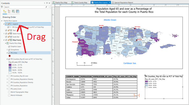

Can you drag the PR_Cities layer from the map into the legend in the Contents Pane?
We should see the PR_Cities layer under the 'Legend' element in the Content Pane.
The layer is not within the Legend element. It's either been removed, or the sync settings for the legend weren't setup for it to be added i.e. synchronize legend with map when new layer is added.
OK that worked -- thanks! But, ALL "synchronized options" in the Legend Properties are turned on (check-marked), so I don't know why it wasn't listed? ...Like I say, I've seen some other inconsistent behaviors with this Legend Item listings recently, as well. For instance, sometimes ALL layers from the Map are listed in the Layout even if they are NOT turned on (visible) on the Map; yet other times, ONLY those tuned on are included; yet other times -- like this -- some are, and some are not.
