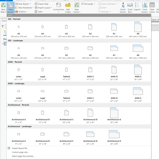

When I open the New Layout gallery the ISO-Portrait, ISO-Landcape,.... Layouts are shown.
Where are these files stored?

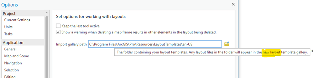

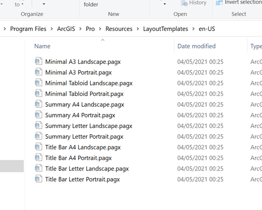

These are not the files stored in the default path in the "Import gallery path"-option:
Even changing the path in the "Import gallery path" option to a folder with custom layouts does not change anything.

The options available from the New Layout gallery are not accessible and this gallery is not customizable. The "Import gallery path" that you refer to belongs to the Import Layout gallery and not the New Layout gallery.
I noticed that the tool tip for the "import gallery path" control on the Layout tab in the Options dialog refers to the new layout gallery.
This is incorrect. I'll enter an internal bug to have this changed.

in fact, now I know the two galleries for the tow commands:
New Layout (not customizable)  and Import Layout (defined in the path)
