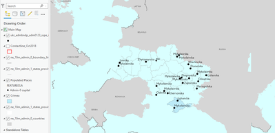

My layers often fail to draw completely or partially. I have received no error messages about cache capacity. I've tried clearing the cache in Display settings and that did nothing. This has happened to me in multiple projects, not just in one.
Here's a screenshot of the partially drawn layers. Most of the blue should be covered by grey or white polygons:

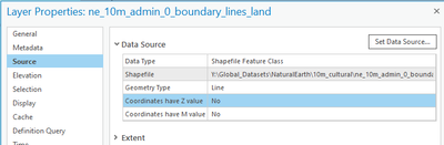

I'm working in a remote desktop and I'm pulling the data from a drive accessed through the remote desktop (see below for what the path looks like). Don't have an Enterprise Geodatabase. Thanks for your help!

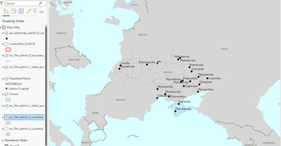

I just ran Repair Geometry on two of the layers that aren't rendering correctly, and it added one of the missing country polygons but that seems to be it:

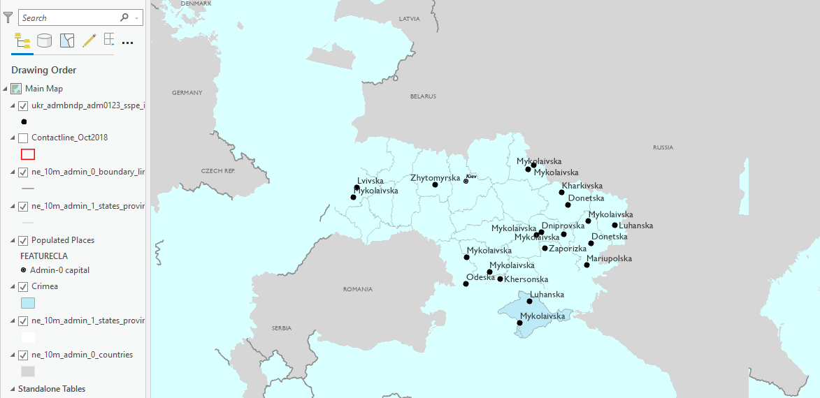

This solved the issue, thanks so much!
