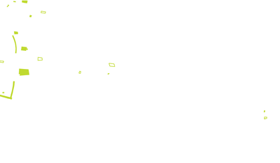

I have a polygon layer, I wan to export  it as kmz, when I use the tool, it works without any warning, but when I open the kmz file in google earth pro, some features are displayed s as label, no polygon.
I opened the kmz in ArcPro or even QGIS  but I notice some polygons are missing.
I tried several time but the issues still exist.
I exported same layer to kml using QGIS, all feature are exported without any issue. That means nothing wrong with the layer.
Note: my layer contains sjut single part polygon.
Has anyone faced this issue.
Layer exported from ArcProLayer exported from ArcPro
Same layer exported from QGISSame layer exported from QGIS
