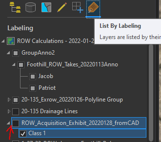

Try clicking on the List By Labeling option at the top of the table of contents to make sure all your check boxes are checked on for labeling:

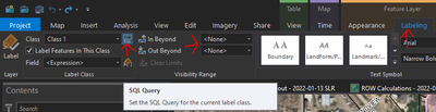

Also, check your zoom ranges (set to <None> if you don't want a zoom range) and check your expressions to make sure they are not limiting you:
