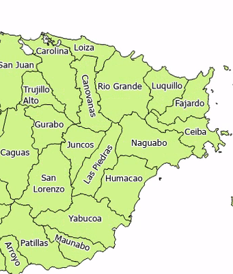

Hello, see map below, where two county labels disappear at certain (larger) scales ...as I zoom in, in other words. I realize that it's probably because those two counties are narrow, so the label doesn't fit.
But, how can I control this so that they stay put?
Thanks, CCE

The ArcGIS Pro label engine has a huge amount of options for placing and fitting labels and for conflict resolution.
Take a look at the docs: Label with the Maplex Label Engine—ArcGIS Pro | Documentation
Some solutions for your problem:
  • Use straight label placement instead of horizontal:
  • Don't try to place the labels at fixed positions:
  • Play with the Overrun and Reduce Size parameters
  • Just force all labels to appear

Craig_Eissler_Iceman
Great suggestions, Johannes -- 2 out of those 4 did the trick!
I have a few tiny islands just off the south coast that are part of counties on the main island. So, some options attempt to label those as well, but those are unnecessary.
