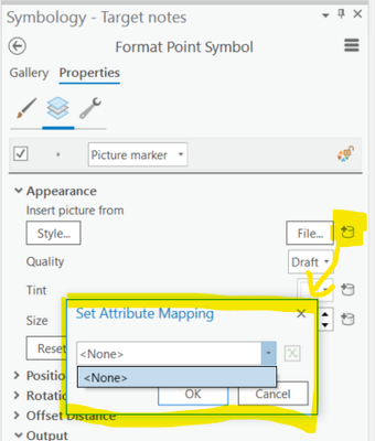

From the documentation here (shown in the screenshot below), I'm fairly sure that this is possible, but I can't work out how to go about doing it and haven't been able to find any walkthroughs/tutorials/similar questions.

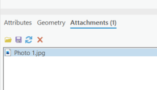

I have a layer of points with images attached as below:

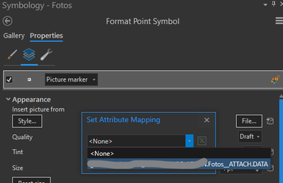

and have got as far as trying to set attribute-level image marker symbols for the points, but when I click the highlighted button to set the attribute mapping, there are no available options to use the attached images.
Do I need to attach the images in a different format in order to be able to use them in this context?

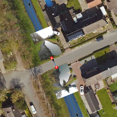

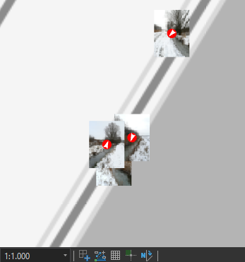

A working, but basic approach:

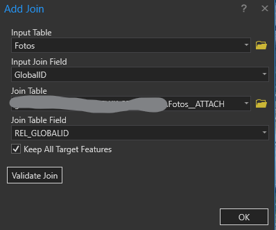

  1. Join the Attachment table to the feature class.
  2. You can now choose the DATA field of the attachment table as input for the picture marker

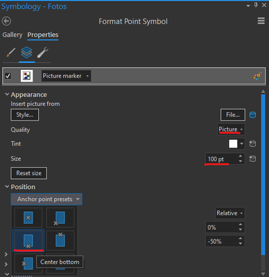

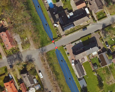

Basically, that's it. To make it prettier:
  1. Set size and quality, set position to "Center bottom"

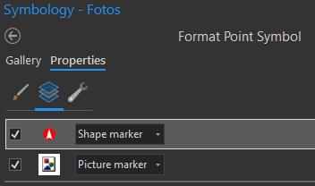

  2. Add a marker layer on top of the picture layer, style it

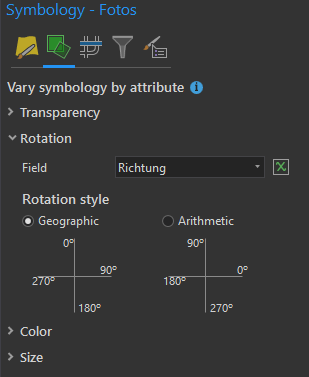

  3. rotate the whole symbol using a rotation field
Before:
After:

What format do the photos in the attachment table need to be?
The field mapping only recognizes BLOB (Binary Large OBject, so byte data) fields. If you have an ArcGIS Attachment table, there should be a BLOB field in there. If not, you can also create a BLOB field in your feature class and store the images there.

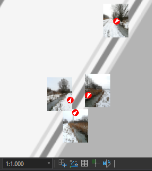

With Python? You could map X and Y offset to fields in your feature class. You could then calculate these fields with Python, using the distance to nearby points as input. This could work for a fixed map scale and picture marker size. But as soon as you zoom out, the images will overlap each other again.
A simple approach to that with Arcade:
// calculate field OffsetX
// load other features
var gid = $feature.GlobalID
var fs = Filter(FeatureSetByName($datastore, "FeatureClass"), "GlobalID <> @gid")
// get nearby features
var nearby_features = Intersects(fs, Buffer($feature, 50))
// gravitational force in horizontal direction
var force = 0
for(var f in nearby_features) {
  var dist = Distance($feature, f)
  var dx = Geometry(f).X - Geometry($feature).X
  force -= dx / (dist * dist)
// magical number dependent on map scale and picture marker size
var magic_factor = 100
return force * magic_factor
// calculate field OffsetY
// gravitational force in vertical direction
var force = 0
  var dy = Geometry(f).Y - Geometry($feature).Y
  force -= dy / (dist * dist)
Without offsets:
With offsets:
