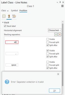

JesseWickizer
This is likely from an invalid stacking separator in the labeling settings. In the Label Class pane Position tab, Fitting Strategies tab, expand the Stack section.
The Stacking separators here can only be 1 character (with the exception of space which uses "space" as the placeholder for the space character), and there can't be stacking separators listed more than once.
