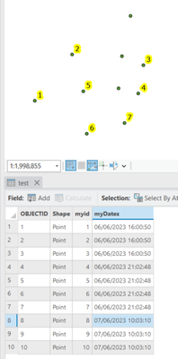

With my test data written to in-memory:
I can use the following SQL query to limit the data:
myDates > timestamp '2023-06-06 16:00:00' And myDates < timestamp '2023-06-07 04:00:00'
