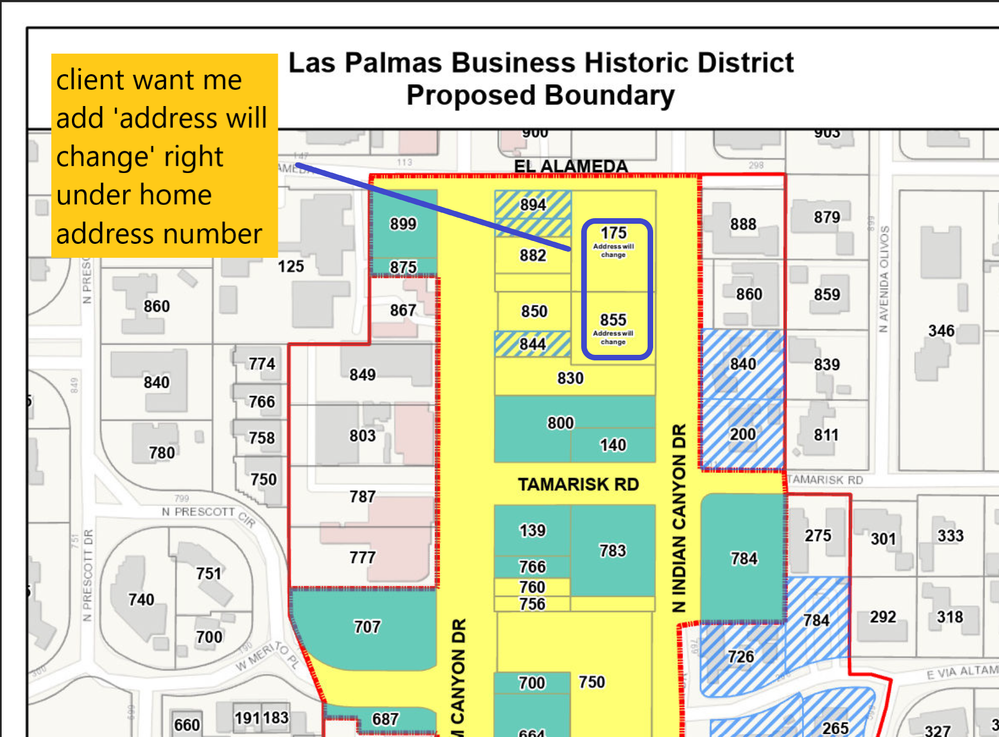

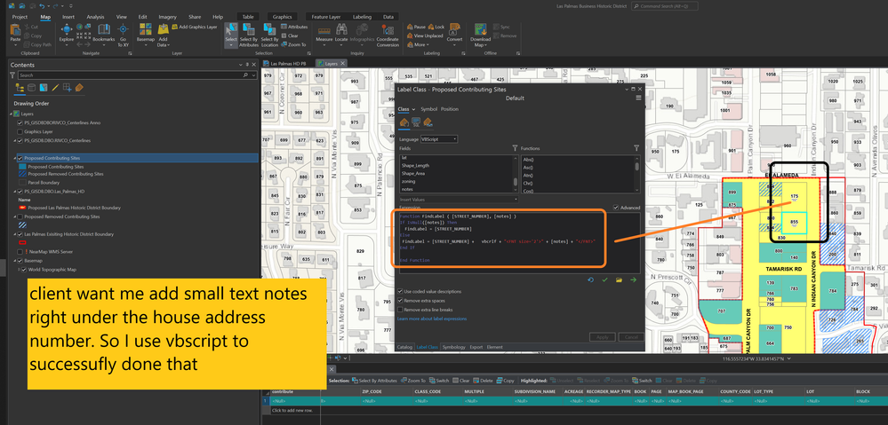

GISAdmin4
Here is my working sample with ArcPro in 2023.
Function FindLabel ( [STREET_NUMBER], [notes] )
If IsNull([notes]) Then
  FindLabel = [STREET_NUMBER]
Else
 FindLabel = [STREET_NUMBER] +   vbcrlf + "<FNT size='2'>" + [notes] + "</FNT>"
End If
End Function
