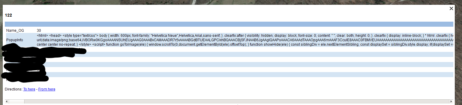

I am receiving KMZ/KML data from a client. I am then asked to do some geoprocessing tasks inside ArcPro to create some needed fields. I am then asked to provide a deliverable of a KML/KMZ but when I run Layer to KML the output KML file does not retain the original popup info. The html line in the popup info field is the same as the original KML/KMZ but only displays as such. I can go into the properties of the new KML and copy and paste this html but then it gets rid of my new fields.
I have a lot of data so manually editing each description is not really plausible. The client understands and has been working for sometime to switch from KML/KMZ (google earth) to shapefiles (ESRI or QGIS they are still in talks) for their data, but until then asked if I could workshop solutions.
Can anyone help me out?
Thank you!

Thank you but this does not address the issue I am having.
I need the original KML popup info to continue to show as normal, while also showing my created fields.
