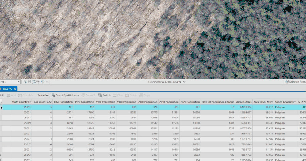

Currently using the 3.2.1 version and like the title says I'm looking for a way to keep the attribute table active after panning. I'm using the keyboard arrows then CTRL + N to pan. After panning, the map window becomes active (arrows nudge map). I want to be able to use arrows to just go to the next record so I can pan again. Is this possible? Thanks for any help.

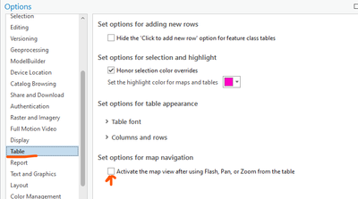

@celtics08 we're adding an option for you to control this in ArcGIS Pro 3.3 (scheduled for May). It is in the Table options > Activate the map view after using Flash, Pan, or Zoom from the table.
That should give you what you're looking for.

Does @KoryKramer know if there is a keyboard shortcut to give the attribute table focus?
Would you be able to show us a screen recording video using a program like ScreenToGIF? Enable keystroke display in the image tab and save the file as an .mp4.

Maybe that’s because you’re a new member. Does a GIF work? You should be able to change the file type to GIF in ScreenToGIF in the Save As pane.
celtics08
Hope this helps visualize this issue, thanks for the tips so far, I really appreciate it.
celtics08
Excellent news! Thank you for letting me know!
