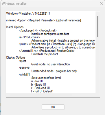

I have completed steps 1-4, but when I kick off the install, I get windows install box with some msiexec commands so I am guessing i have something incorrect in my syntax.  This box just pops up, I click ok, it goes away and I'm left with a blinking cmd line again.

PS C:\GIS\ArcGISPro> msiexec.exe /a \ArcGISPro.msi INSTALLDIR="C:\Program Files\ArcGIS\Pro" ADDLOCAL=Pro ALLUSERS=2 ACCEPTEULA=YES ENABLEEUEI=1 CHECKFORUPDATESATSTARTUP=1 /qb

ok...I was able to get it installed. The solution above in the link does indeed work, but in my case, what I found was, even though I was running msiexec from the directory where the files were I still needed to use the literal path and change the a to a I, which I was doing initially. I only added the entire path out of frustration, but I am glad I did.

C:\GIS\ArcGISPro> msiexec.exe /i C:\GIS\ArcGISPro\ArcGISPro.msi INSTALLDIR="C:\Program Files\ArcGIS\Pro" ADDLOCAL=Pro ALLUSERS=2 ACCEPTEULA=YES ENABLEEUEI=1 CHECKFORUPDATESATSTARTUP=1 /qb
