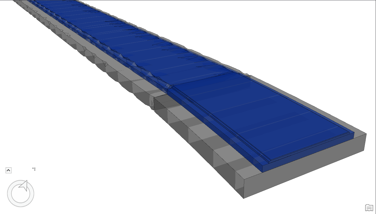

What I have is an Autodesk Civil3D file containing solids.
Converted those to Multipatche featureclasses in a file geodatabase using FME Desktop 2018.

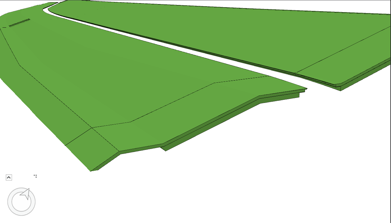

In ArcGIS Pro 2.3.1 I created a local scene and imported the Multipatch featureclass. This works great as shown below.
Next I used "Create 3D Object Scene Layer Package" to export a .slpk and Uploaded to ArcGIS Online.

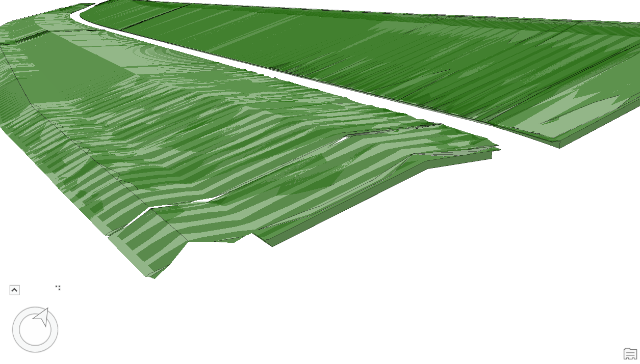

Published to Hosted Scene Layer. This time the result is not what I hoped for.
Using "Validate Scene Layer Package" I tried to understand what went wrong. The log:

Did google "extends outside the mbs of its parent" but only found my own question on SE. I suspect it has to do with the proportions of the objects and the level of detail, but did not trip over guidelines. Somewhere in the model the more compact objects visualise correct where the long objects don't.
What am I doing wrong and how do I solve this? Thanks!

Andrew--Johnson
We've made some enhancements under the hood in 2.4 so I went ahead and created the slpk in 2.4 and consumed it in ArcGIS Pro and the Scene Viewer in ArcGIS Online and it looks significantly better. I attached the slpk. Can you take a look and confirm that everything looks good?

Andrew--Johnson
Hi Niels,
We investigated this and it looks like there is a lot of z-fighting occurring with this particular dataset. In 2.4 we enhanced the tool to better handle these types of situations. As of right now the only way to remedy this is to utilize the new enhancements at 2.4. ArcGIS Pro 2.4 will be released in June.
If you want a deep dive on the i3s specification the doc can be found here https://github.com/Esri/i3s-spec/blob/master/format/Indexed%203d%20Scene%20Layer%20Format%20Specific...
