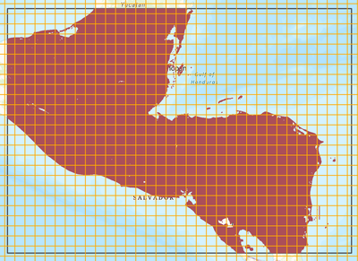

Please see the snip below of a subset of my 1-km raster data points with overlaid 40-km windows. For use in Extract Values to Points, this is a raster but I wanted to visualize it as polygon. I can do one iteration of the extraction, but the remaining challenge for me is shifting the 40-km layer iteratively so that each time I run Extract Values to Points, a slightly different set of 1-km points is assigned to each 40-km raster window. I have tried several things but keep running into dead ends when it comes to the shift. Please let me know if you would like further clarification. Thank you!
