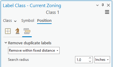

The Remove duplicate labels label placement property is the closest way to achieve this without any further editing, but it won't take into account contiguous areas exactly like you wish.
If you must only have 1 label per contiguous block of similar parcels, you should dissolve the parcels layer by the zoning attribute (do not Create multipart features), then use the resulting zoning areas layer to label the map with 1 label per group of parcels of the same zoning.
