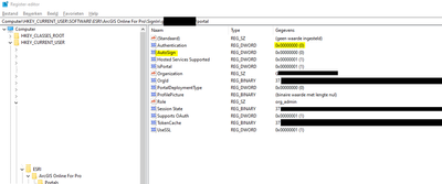

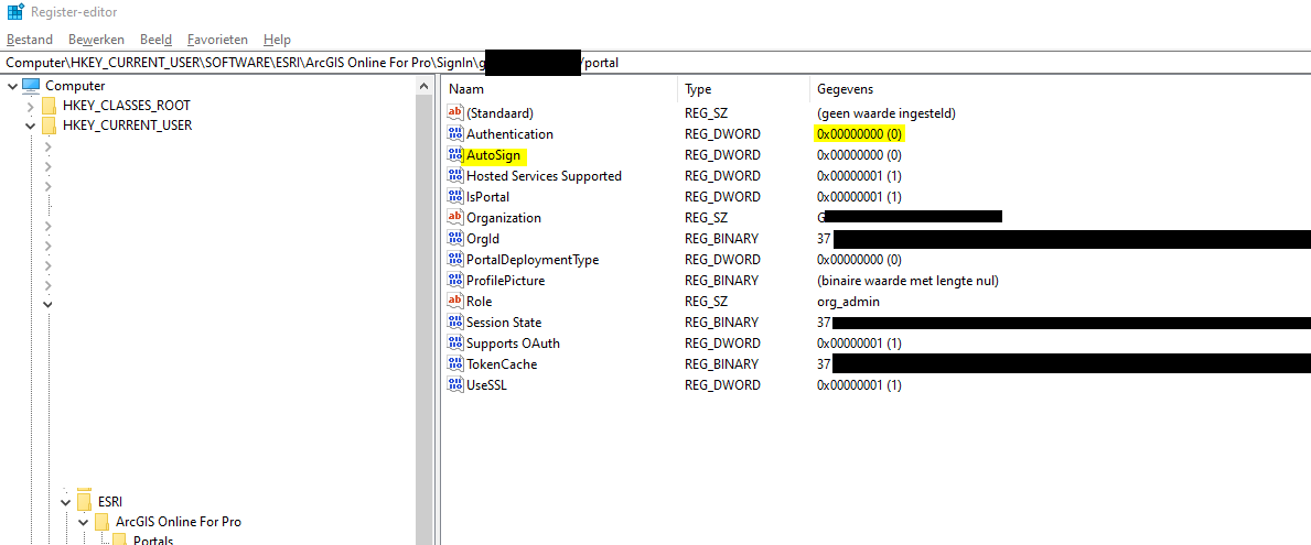

We have found a solution by removing some key registries as explained here: Perform an ArcGIS Pro soft reset. More specifically, we have narrowed it down by only changing the following 2 yellow keys (black lines are names/tokens of/for our portal) :
- Changed the 'Authetication' file from 0 to 2
- Deleted the 'AutoSignIn' file
After changing these 2 keys, the ArcGIS Pro license follows the SAML authentication procedure correctly. The advantage of only changing these 2 specific keys is that the user does not need to setup the license URL again. This is something which users needs to do if the whole ArcGIS Online For Pro\SignIn folder is deleted in the key registry (as suggested in the ArcGIS Pro soft reset procedure).
